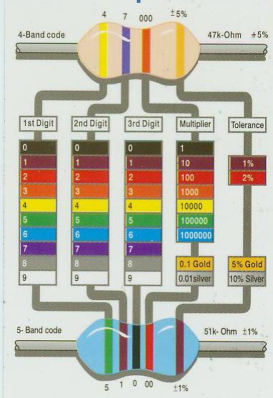

Post by bitfogav » Mon Aug 02, 2010 9:19 am
I came across this and thought it would be good to put here :)
its for a 4 and 5 band resistor colour chart
resis colours.jpg (39.75 KiB) Viewed 12165 times
Post by brad » Mon Aug 02, 2010 10:31 pm
A very welcome addition!
