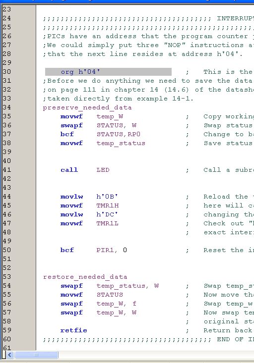

Lines 1-24 in the picture below are really no different than in the original LED flasher except we only need two variables. A temporary status register, and a temporary working register. Anytime an interrupt is used it is a good idea to store the current values in both the status and working registers so when you return from the interrupt, everything is the same as before the interrupt.
Lines 25-61 contain the interrupt routine but I will skip over that and explain the setup routine first.

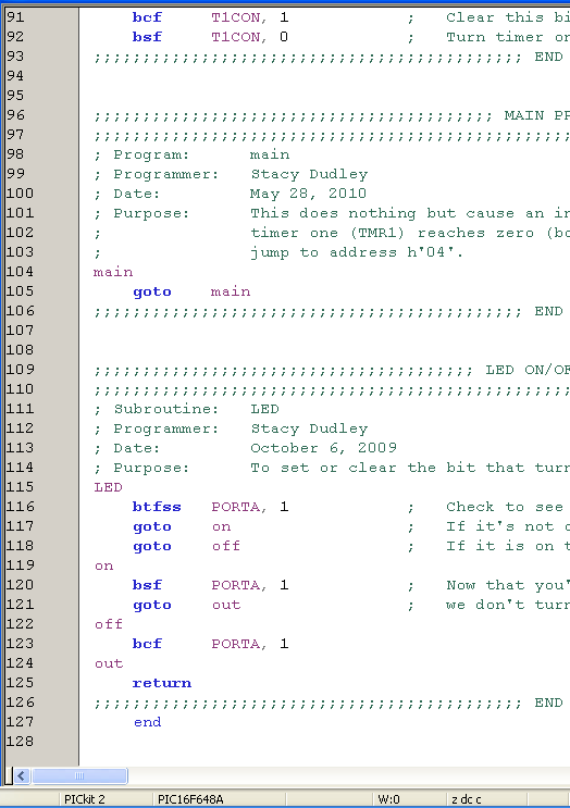

Lines 97-127 in the picture below show the main program and the subroutine that turns on and off the LED. The main program does absolutely nothing! It is an infinite loop and simply waits for the timer to reach 0 where it will trigger the interrupt.
The LED routine simply checks the status of a bit. If it is set, it clears it, if it is clear it sets it (in this case - PORTA, bit 1).

Lines 25-61... You will notice this program has an additional “org” directive (org h'04'). This tells the PC that this is where we want to jump to when an interrupt occurs (remember the PC jumps to address 0x004 upon any interrupt). I could have simply added three “NOP” instructions following the “goto setup” as follows to achieve the same result:

As noted earlier, it is necessary to preserve the data within the working and status registers upon handling an interrupt. The comments withing the program explain this a little, however it is best to read about handling this in the PIC16f648a datasheet on page 111 section 14.6. Lines 35-38 handle the preservation of this data. Line 41 simply calls the LED subroutine to turn on or off the LED. I could have placed this code within the interrupt but I thought it would be useful to leave it in a separate routine and show how you can jump in and out of the interrupt just as you do any other routine. However, make note that it would not be good to use a GOTO instruction that makes the PC jump outside the interrupt or you will never return from the interrupt.
Lines 44-47 reload the TMR1 high and low registers with the values needed to retrigger the interrupt, and line 50 resets the TMR1 interrupt overflow flag (remember this has to be reset by the programmer). Lines 54-57 simply restores the working and status registers original data, and line 59 tells the PC to return to the place it was before the interrupt occurred.

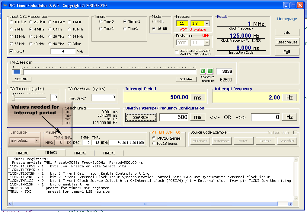

Well that's it... an “over-explanation” of a very simple program! I hope I wasn't too confusing and that it is beneficial to someone who is interested in knowing how an interrupt can be used. Below is a picture and link to a great little program that will help with calculating timer values so you don't need to rack your brain trying to calculate prescaler settings, etc. Just select which timer you want to use, pick a frequency or time you would like to use for the interrupt cycle and BAM, it's done.
(You can download the fullsize image here)
http://www.bradsprojects.com/phpBB2/upl ... or_155.gif
http://pictimer.picbingo.com/
Enjoy, and please feel free to comment or ask questions if I wasn't clear enough!
PS> Play around with the values that are loaded in the TMR1 high and low registers and watch how the LED blinks faster / slower. Also, experiment with the picbingo timer calculator to set the frequency of the flash times. The values I have chosen will create a 500ms interrupt cycle (the LED will stay on for 500ms then turn off for 500ms).
