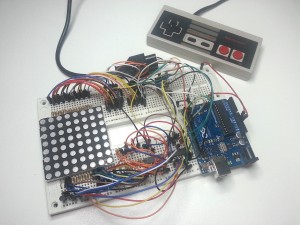

No that looks like the correct 8x8 Matrix, Have you got the matrix the wrong way round?
check out this picture of a matrix I have on a breadboard, you can see the writing on the side of the matrix, and then you see the coloured wires going to the one side of the matrix,
The wires go to these pins.
Green wire = Green leds
Orange wire = Red leds
Yellow wire = Power supply
Im guessing if the writing on the side of the matrix is the same as yours then you have the right 8x8 matrix..
hope this helps - just ask if you need more help :)

Post by bitfogav » Sat Aug 14, 2010 3:16 am
Heres a better picture of the details on the side of the matrix..

Post by bitfogav » Sat Aug 14, 2010 5:55 am
The schematics of Brads 8x8 matrix = Anodes are coming out of the TOP and the Cathodes are coming out of the LEFT which connect to the 7442.
On your schematics the Anodes come out of the LEFT and the Cathodes come out of the TOP.
Brads schematics isnt like for like with the datasheet.
Anyway Pin 1 of the 7442 is connected to Pin 24 of the 8x8 matrix.
Pin 2 of the 7442 should then connect to Pin 21 of the 8x8 matrix.
Pin 1 of the 8x8 matrix is the TOP LEFT if you are looking down at the TOP of the matrix ( but note that the writing on the matrix should be on the left hand side as I am showing you in my pictures above)
Hope that makes more sense now :)
