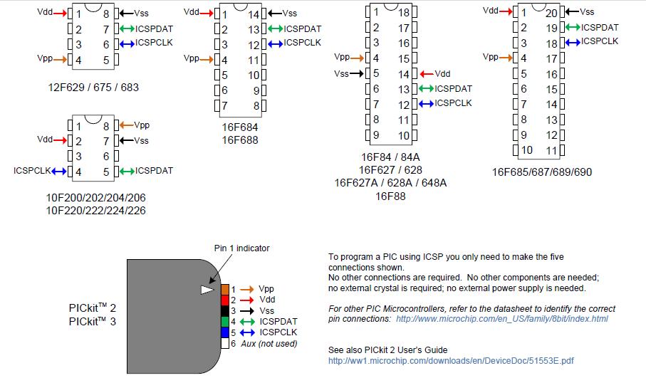

Heres how to connect up some 10F, 12F and 16F series microchips, I will add some 18F series soon :)
Heres the links on the picture:
For other PIC Microcontrollers, refer to the datasheet to identify the correct pin connections:
http://www.microchip.com/en_US/family/8bit/index.html
See also PICkit 2 User’s Guide:
http://ww1.microchip.com/downloads/en/D ... 51553E.pdf
Some other notes, make sure that you have no components connected to the ICSPDAT and ICSPCLK Lines, has this can stop the pickit2/3 communicating to your microcontroller, especially if you are programming the microcontroller in circuit.

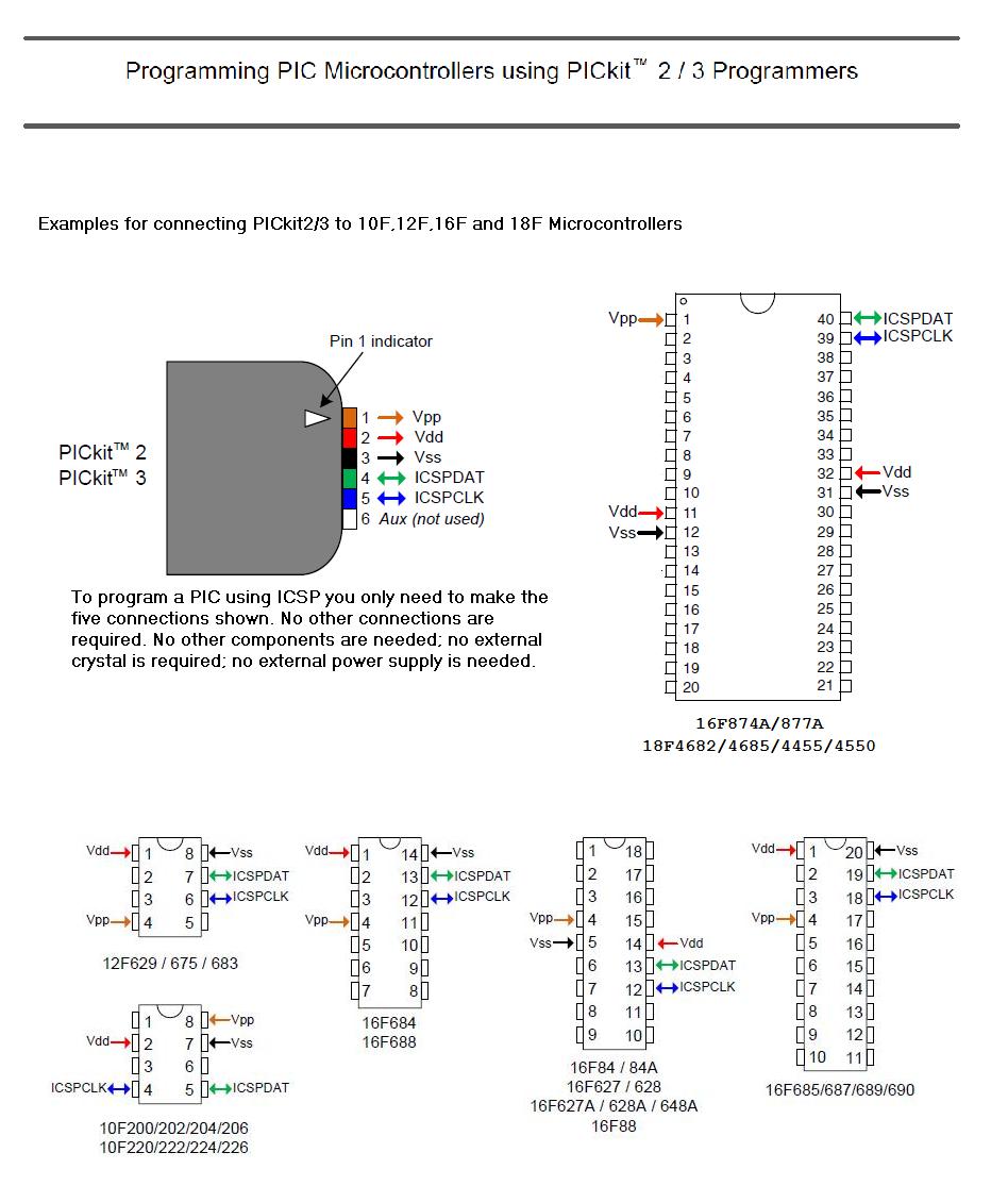

Heres an updated version, inc connecting up 40pin microchips.
Connecting pickit to microcontrollers1.jpg (118.83 KiB) Viewed 37590 times
If you would like to download this information for reference purposes then you can download my PDF I put together.
Connecting pickit to microcontrollers.rar
(206.54 KiB) Downloaded 1497 times
