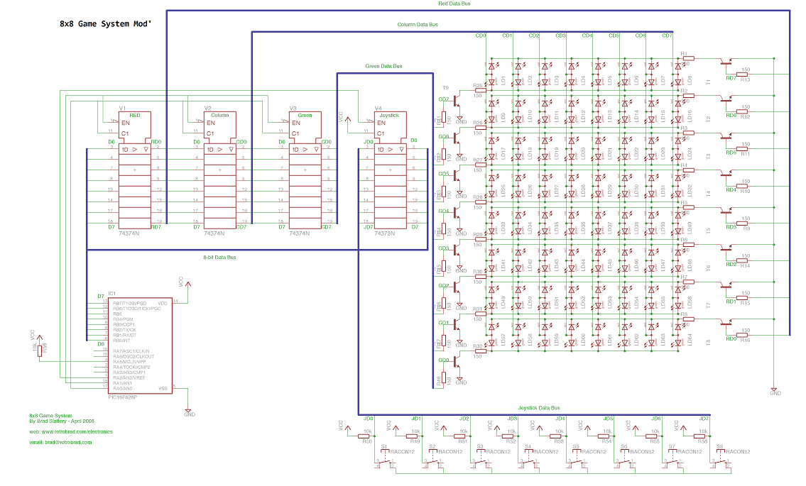

io. wrote:
brad wrote:What you need is a way to expand your output ports.
The best way to do this (in my experience) is to get some 74373 chips.
They are 8-bit data latches with tri-state outputs.
What you can do with these is get three of them. connect the eight inputs of each one to PORTB of your microcontroller (so they all have exactly the same inputs)
Then connect the eight outputs of each chip to your eight red cathodes, your eight green cathodes and then your eight anodes. (one chip for each section)
Then, connect the latch enable pin of each chip to one of the pins on PORTA. So you could connect the latch enable of the red 74373 to PORTA pin 0, then green latch enable to PORTA pin 1 and then the anode latch enable to PORTA pin 2.
Then lastly, the 74373 chips have an output enable pin (because they have tri-state outputs) so you need to connect all three output enable pins of the three chips together, and then to PORTA pin 3.
So, to draw an image you need to send out three bytes of data (one for the red cathodes, one for green and one for the anodes. First send the red byte to PORTB, then enable the red 74373 latch by making PORTA pin 0 a logic 1, then 0 again. Then send the green byte to PORTB and then enable the latch by sending a logic 1 to PORTA pin 1, then make it a zero again. lastly - send out your anode data to PORTB and then send a logic 1 to PORTA pin 2 to enable the anode latch, then make it a logic 0 again.
Now we have three chips, each with their required data. We then make PORTA pin 3 (the output enable connection) a logic 0 (we need it to be a 0 because it has an inverted input at the 74373 for this connection)
This will allow all the data present in the 74373 chips to go out and be displayed on the LED matrix.
Have a look at the 8x8 game system page for full details and a schematic of how I made it all work.
Thanks a lot, I think I have understood the theory. I'm gonna do some reading about the subject :)
I'm about to buy some Motorola MC74F374N, they seem to do the same as 373.
Sorry for a late reply to an old post...
I'm not sure the Motorola MC74F374N is a good choice as the output current specs' seem a bit low, however, there may be advantages using a 74HC374 over a 74HC373. Both parts have the same output current specs and the same pinout but the '374 is an edge triggered D flip-flop. This means that while you can use the '374 in a circuit the same way Brad uses the '373 in his 8x8 Game System, you can also cascade multiple '374 ICs by driving all the CLK and /OE pins together and by connecting the outputs of leading ICs to the inputs of following ICs. The modified 8x8 Game System schematic below shows three 74HC374 ICs in cascade configuration. Now the neat part about this configuration, besides freeing up four I/O pins, is that writing 24 bits of output data to the '374 cascade simply involves clocking three bytes onto the bus. As each byte is written onto the bus it ripples down the cascade. In this case, you must send the Green byte first, followed by the Column byte, followed by the Red byte. I believe the process is simpler and faster than the one described by Brad for the '373 and should result in smaller more efficient code. For example, the code snippets below from the "Invaders" program, which have been modified for the 74HC374 cascade, are nearly 40% smaller than the original code they replace.
Food for thought. Cheerful regards, Mike
8x8_game_system_schematic (small).png (150.66 KiB) Viewed 31468 times

Re: Tutorial 7 - All the info you need is right here!
Post by brad » Fri Jan 04, 2013 9:43 pm
You're certainly on to a good thing there Mike - I have noticed that this is the way that the LED displays that I buy have been running the show. And you are correct - it saves a whole heap of I/O pins and streamlines your code :)

brad wrote:You're certainly on to a good thing there Mike - I have noticed that this is the way that the LED displays that I buy have been running the show.
Cool. What displays, if you don't mind me asking?
That's not all. If you check out the footprint for the 74HC574 you'll think you went to PCB layout heaven (lol)...
Hey, I noticed that no one posted code for your homework assignments. Would you mind if I gave it a try? I'm certainly not an "expert" but I do have several years experience (assembler, BASIC, and C) and maybe someone would enjoy looking at and comparing examples. To be honest, I can't imagine where to begin your HW#2 assignment, but like any good puzzle, I'm sure it would be fun (lol).
BTW, I think this tutorial is fantastic and incredibly well done. I wish I could express myself as well as you. Do you think there would be any interest in supplementing the tutorial with a discussion about current limiting resistors, the 7442 "fanout" and how it effects brightness when lighting multiple LEDs in any particular column, and using transistor or MOSFET column drivers, or, is that beyond the scope of this tutorial?
Happy new year and cheerful regards, Mike
