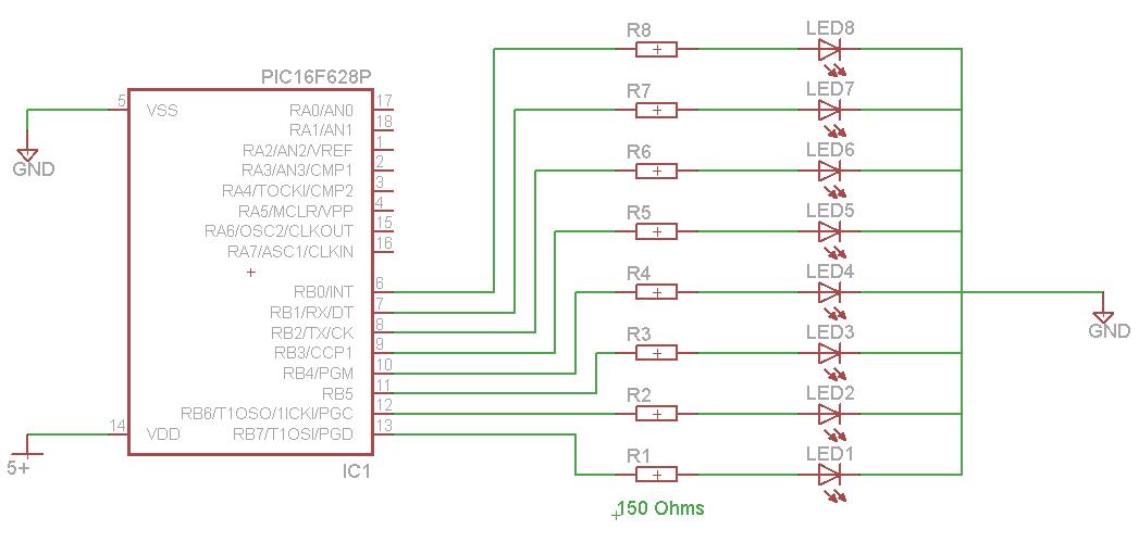

Hello! I find the knight rider of Brad very interesting to make, but i would like to know if any schematic is available?

Heres a schematic that ive put together which should help, I dont think there is a schematics for the knightrider tutorial?..

Post by nodoubtman » Wed Feb 29, 2012 7:18 am
thank you!:)

Thanks formatting that bitfogav!
