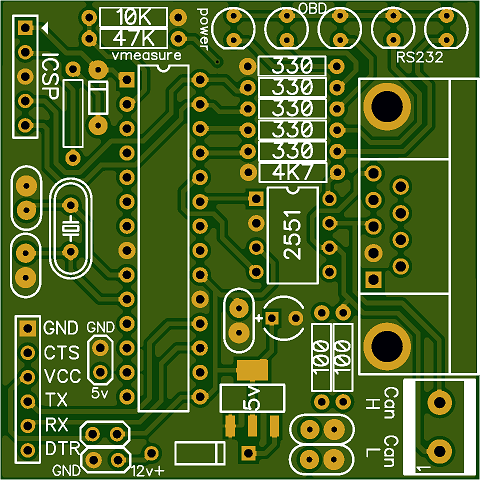

Post by bitfogav » Thu May 17, 2018 3:58 am
I've recently seen a bunch of youtube videos relating to JLCPCB, 10boards for $2, that seems a lot cheaper than iTead PCB, So I thought I would give it a go with my next project. I've placed my first order with them for 50mm X 50mm 10 PCB's which came to about £1.41p here in the UK, wth shipping the total was £5.50p.

I don't remember if I saw it or not. It seems like I have to have seen it, since I check the forum for new posts every day. I should have recommended putting thermal relief around the pads that go to the plane around them. If you wave-solder it and never need to repair or rework it, it's no problem as it is; but if you do need to remove/replace a part that's soldered into one of these pads, it's hard to get enough heat to the pad with a soldering iron to melt the solder when the plane around it is sucking up all the heat like a big heat sink. The board does look nice though!

By the way - it looks like some sort of CAN-BUS interface circuit... interesting :)

Thank you Garth for your recommendations, I will take that on board if I ever redesign or remake this board, has it happens the board actually turned out fine and works perfectly. I used through hole components for quick and cheap design. But I'm really happy with JLCPCB :)
Yes Brad it is a CAN-BUS interface board, solely to interface with Automotive networks, I was working on my own VB project and needed a quick/cheap way to interface with several vehicles. The project isn't finished yet but hopefully get back on it next year.
