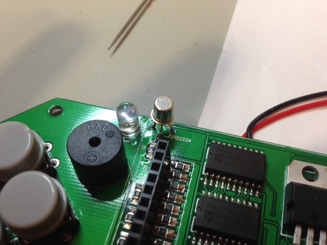

Post by mackletus » Fri Sep 14, 2012 4:27 am
Finally.
Mil Spec Transistor
Ready for war.... lol

Re: Sound problems
Post by brad » Fri Sep 14, 2012 9:03 am
Careful! That thing could take out the LED!
