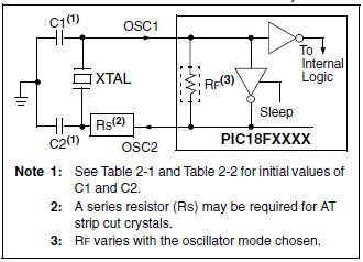

Can you be abit more specific to what you mean by 1 and 2? I guess you mean Osc1 and Osc2? if this is the case then if you look at the datasheet for the 18F4550 its shows the pin connections as Osc1 and Osc2?. But I would add, that it dont make any difference if you connect Osc1 of the microcontroller to Osc2 of the Crystal circuit or vise versa.
This is a image from the datasheet - (ignore the resistor in the schematic as this is not needed)

I mean the 1 and 2 in yellow near the crystal and lines after caps.
Re: Table not doing much
Post by bitfogav » Fri Dec 21, 2012 10:38 am
Oh them, they are just symbols that are automatically inserted with the schematic software. sorry if they have caused any confusion.

Also be mindful that ideally you want to keep the connection between the oscillator circuitry and the PIC pins as short as possible.

Ok, I made the wires really short and placed everything together and connected the add-on board to his big brother. And no weird stuff is going on. I can still play the game and no change ofcourse. The magic will happen with the new code :mrgreen:
