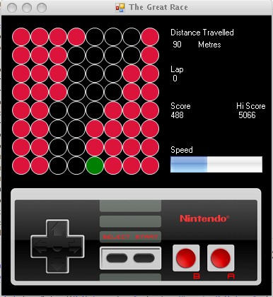

Well, VB is coming along in leaps and bounds and I am having loads of fun learning this new language. I thought what better way to learn this new language than to re-create my very first game - The Great Race!
Well, It is currently in a working state with one track to drive on. This version of the game gives you a running tally of the distance you have travelled, Score and also shows you your speed using a progress bar. The faster you go, the more points you get (I.E. if you go 3000 Metres at a slow speed, you get LESS points than if you went the same distance at a faster speed) It also keeps your high score (up until you quit the game)
I have also incorporated a NES control pad to show you what keys you have pressed.
The interesting thing with VB.NET is that you can't work directly with binary numbers (which is great when working with pixel games like this) Thankfully AndyO from digital-diy has been kind enough to submit a snippit of code which helps in reading individual binary digits within a variable. The Graphic Data for this game is actually in the form of decimal numbers. I made a simple excel spreadsheet which allows you to draw the track, it then converts your track data in the required decimal data to paste into the game code.
Here's a snapshot of excel helping me out!
The keys are:
A = Accelerate
Z = Decelerate
N = Drive Left
M = Drive Right
You can download the EXE file and play this on your PC for yourself!
TheGreatRace.zip
(73.69 KiB) Downloaded 1068 times
And Finally, The Sourcecode:

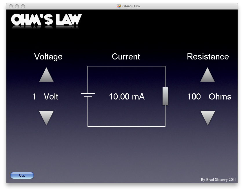

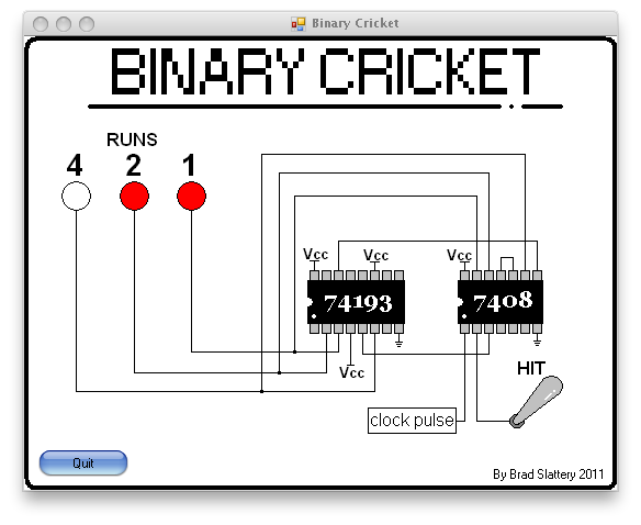

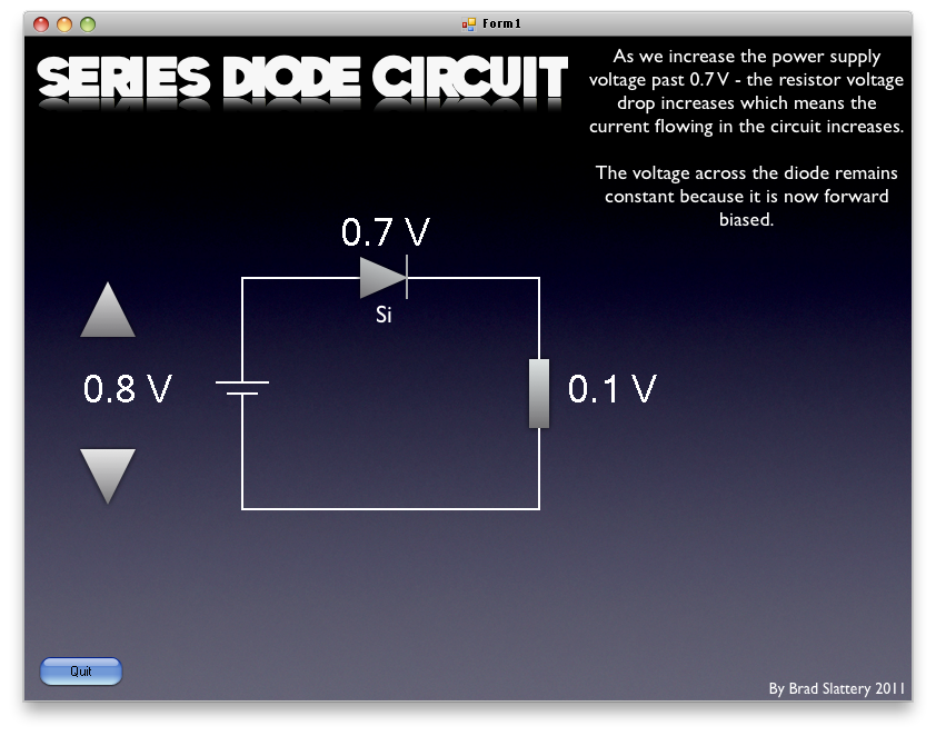

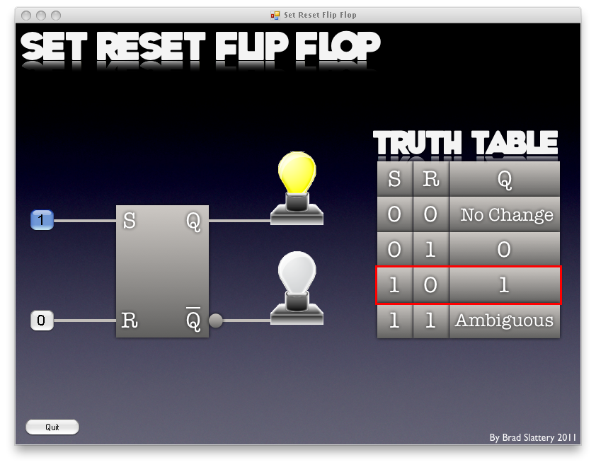

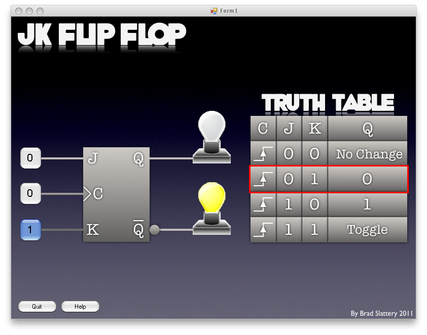

VB has been fantastic - I have actually been spending the past week developing applications in VB for all the teachers to use in class to help explain concepts. It has been a great learning experience for me, I'm getting paid to learn how to use VB :D
applications I made this week were:
- Ohms' Law
- JK Flip Flop
- SR Flip Flop
- Diode Series Circuit
- Binary Cricket (a simple game that basically generates a random number between 0 and 6, if you get a 0 you are out and it's the next players turn, any other number you add up until you get out.) The students build this circuit for themselves.
- BJT Fixed Bias operation (Even plots the Qpoint for you!)
- Logic Gates
