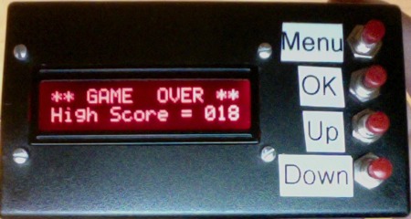

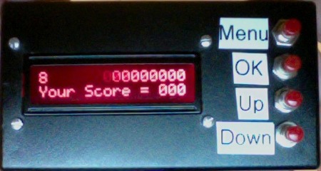

Here's a couple of photos:
For those interested, here's the code:

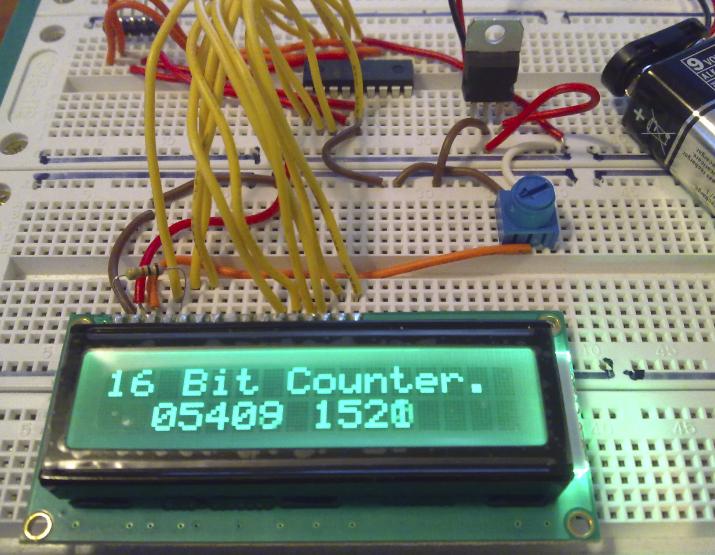

This is a 16bit counter on a LCD display I made up.
And heres the souce code to give people an example of how much different the programs are :D

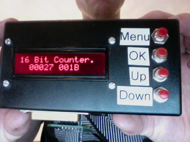

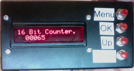

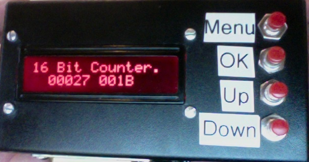

Very nice indeed! Thanks for posting that.
i am not sure what those extra numbers to the right of screen are, but here is my version of the 16 bit counter, it just increments by one each second.
Here is the code:

Posts: 908
Post by bitfogav » Sun Jun 20, 2010 8:57 am
The numbers to the bottom right of the screen are the hexadecimal numbers.. :) they count up aswell as the 16bit counter
Posts: 2576
Post by brad » Sun Jun 20, 2010 9:00 am
bitfogav wrote:The numbers to the bottom right of the screen are the hexadecimal numbers.. :) they count up aswell as the 16bit counter
Here's my ammended code, I have added the line:
LCD.WriteAt(2,9,convert.hextostr(counter,4))
