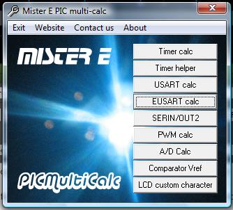

Hi everyone I came across this piece of software and thought I would share :)
Its very useful for working out your Usart settings and Timer settings for PICS, also many more features like PWM and A/D.
Example: Heres the EUSART Calc set with a clock of 48Mhz and a baudrate of 250K, the output settings if I was to set BRG16 = 1 and BRGH = 1 then I would enter the Value 47 into the SPBRG Register, this will setup our EUSART with a baudrate of 250k (example DMX Protol baudrate).
