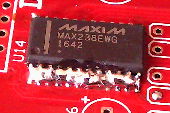

Here's another one, an SOIC. These were taken with a very cheap camera.
First I tack one corner, and get the IC really straight, then tack the opposite corner, and again make sure I haven't rotated it out of being straight. Then I do the two remaining corners. Then I flood a whole side with solder, then the other:
Then I hold the board vertical and slowly go from the top of a row to the bottom with the big soldering-iron tip as described above. The excess solder comes off on the tip, leaving this:
Again, my apologies for the quality of the super-cheap camera. And I don't have enough hands to photograph the process while I'm doing it. Maybe I should try to coordinate the next time with someone who can help.

The picture quality is good, and the soldering joints have turned out perfectly, looks very clean :D
