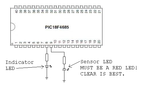

I have this simple circuit here which is great for testing. I am using a pic18f4685 just because it's my pic of choice at the moment, but is easily ported to most other pics.
There are two LED's in the above image - oh by the way, the resistors would be fine if they are around 150 ohm. One LED is used as the sensor (it is connected in reverse bias. The other LED is an indicator LED that shows us when we have covered the sensor.

Now the code is a little bit involved, but it's due to the calibration routine. The calibration routine ensures that it will work correctly regardless of where you use this project. It checks the ambient light over a period of time and saves the ambient light data for use as a comparison. During the calibration if the light makes quite a large change (by someone shining a light on it or covering light then the calibration starts again. It only takes a few seconds to calibrate.
Then it just checks to see if the sensor data is quite a bit off the calibrated data, if it is then it must mean that we have covered the LED sensor.
I have also included an LCD display in my test version which gives me real time info as to the exact condition of the light during calibration and also after calibration.
