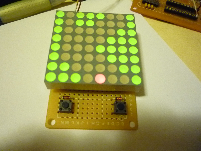

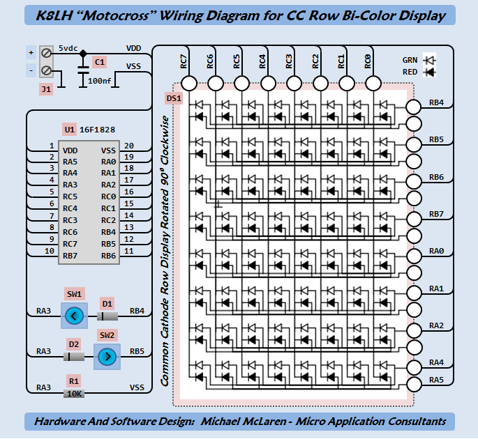

At Brad's invitation, here is a preliminary wiring diagram and a picture of the prototype for my single chip 8x8 game based in part on his old "Great Race" project. The low parts count design will support both CCR (common cathode row) and CAR (common anode row) type red/green displays by changing the polarity of diodes D1 and D2 and by configuring R1 to be either a 'pull-up' or a 'pull-down'. I would be happy to post software at a later time if anyone is interested. Right now I'm having way too much fun coding game variations and tweaking program performance (lol).

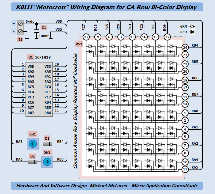

You're welcome to post this design on your Great Race page, Brad. I've added an example wiring diagram for the "common anode row" type display below with pin numbers for the little 1.25"x1.25" Sure LE-MM103 display, which I believe is similar to the one you used on your original Great Race project. Compared to the diagram for the other type display, notice that the pull-down resistor R1 is missing in this diagram and the polarity of diodes D1 and D2 is reversed. Please note that the software is slightly different for each type of display too.
