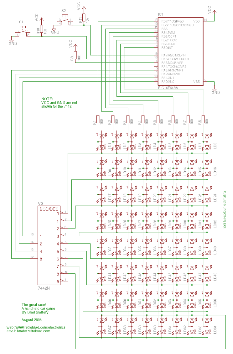

On my project i just made, the red dot that moves is only red if you disconnect the green vertical column. I noticed on your pictures of 'the great race' you have a fully red dot (not orange) along with that row of green. All i did to get rid of the orange to make it red was disconnect pin 10 on the led display.
Can you possibly edit you 'the great race.asm' on you great race page that fixes this...It would be very much appreciated, but it doesn't matter if you cant.
Thanks heaps , great project.

Hi bman2309, Im not sure that Brads .asm code needs fixing as Brads track actually goes into the last row with the RED dot car. Correct me if im wrong but if the red dot car turns Orange then this indicates that the car as crashed?. But are you saying bman2309 that your Red dot car was always Orange untill your disconnected pin 10?

Let me double check the code and get back to you. But it should be just fine. have you checked your hardware?
is there any other sort of ghosting? I.E. pixels lighting up when they shouldnt?

Hmm, I have checked the code and it all looks good. Unfortunately there's something not quite right with your circuit.
Just as bitfogav said, double check everything to make sure you don't have shorts where there shouldn't be shorts :)

I haven't built the 16F648A+7442 Great Race project but I did wonder if there is an error or oversight in the schematic (which might explain those symptoms). With the 7442 "D" input (pin 12) wired to ground, one of the green rows on the 7442 "0" through "7" outputs will ALWAYS be enabled, yes? If that's the case, then when you set RA3 low in the software to enable the red row, one of the green rows is still enabled, and that means whenever you light a red dot you'll also light a green dot. Now I haven't seen this phantom green + red dot in any of the Great Race videos I've come across so far, so I was wondering if my analysis is incorrect?
If my circuit and software analysis is correct however, then couldn't you eliminate the problem by using all four of the input address lines on the 7442 to fully decode and enable only "1 of 9" outputs for all nine rows (8 green rows + 1 red row)? That is, why not drive the 7442 "D" input from the RA3 line and use the 7442 "8" output line to drive the red row? Perhaps something like the circuit below?

You will get ghosting if you don't first ensure that you are sending all 1's out to cathodes of the Green LED's. If you do this then there is no way that any of the green LED's can light up because you have 5v connected to all of the Cathodes :)

I agree with you 100%. Unfortunately, I don't see any way you can set all of the green cathodes to 5v on your schematic. With pin 12 grounded on the 7442 in your circuit (the A3 input in the table below), there are only eight possible combinations of outputs and one of those outputs (all connected to green cathode rows) will always be low.
