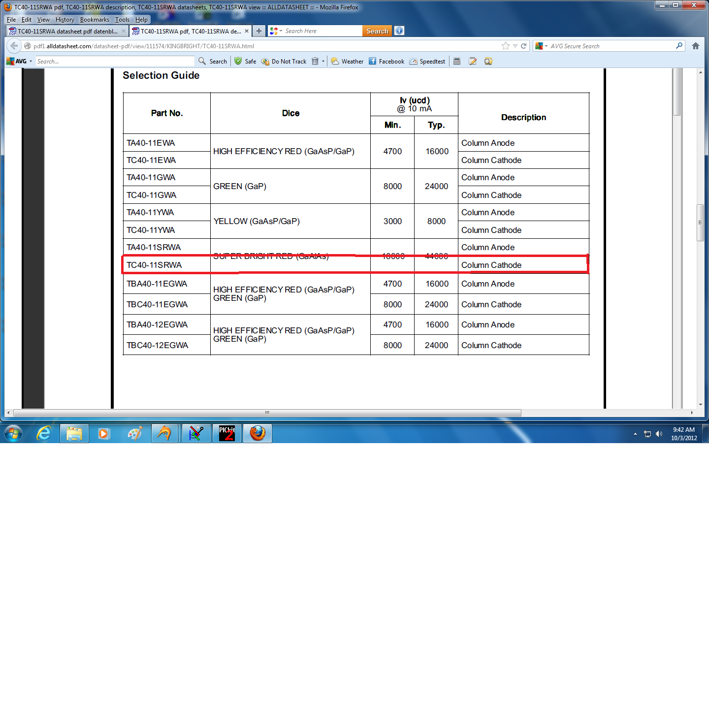

The matrix is a common cathode
TC40-11SRWA
I know its kinda confusing what is what. I did a google to double check just what defines a common cathode and common anode.
Trying to find a multiplexing . bas module. MIGHT? aid in the blinking between one row to the next. Need to SMOOTH it out. Maybe multiplexing?
Graham over at DDIY made note of a bas module he used but no post on its contents.
will post a video of what I have so far. kinda clunky
TC40-11SRWA
- common cath.png (343.4 KiB) Viewed 22624 times
Re: Bi-Color matrix
Unfortunately it isn't a common cathode matrix. If you have one set of anode connections and two sets of cathodes then it means it is common anode. I.E. the anodes of the red and green LED's are connected together and are therefor common.
If you build the circuit I drew it will work for you (that's how I normally run a common anode LED matrix).
You can then just copy and paste the Christmas code that I put up in a previous post - you will just want to modify it slightly to suit a 5x7 matrix as opposed to an 8x8 matrix.

Re: Bi-Color matrix
OUPS I grabbed the wrong circuit board. I have two boards that look identical
the correct number is TBC40-11EGWA which is a bi color common cathode. The number I posted (TC40-11SRWA) is common cathode but one color. I reconfirmed this from the manufacture as well.

Re: Bi-Color matrix
Unfortunately you must be connecting something up incorrectly.
LED's will have a forward voltage drop around maybe 1.8V - 2.5v (roughly) You can run them quite happily on 5v (with a series resistor)
I have even run an LED matrix with a 3v coin cell battery. I'm happy to order a 5x7 matrix and show you that the circuit will work. It is a tried and tested method

Re: Bi-Color matrix
The Kingbright LED matrix I am using (TBC40-11EGWA) has a 4Vf on each LED segment. This i where the problem is.
Hopefully the TD62783APG will solve the higher voltage issue. I have to increase the voltage due to the 4Vf issue.
Have tried several different methods but going to wait for parts.
