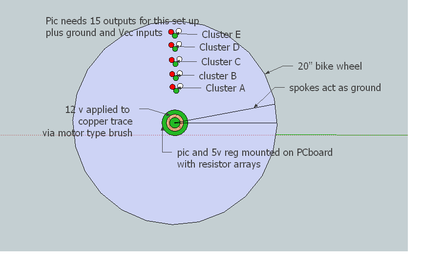

I was wanting to go with using an actual graphic but need to look at the code the download generates but for simplicity this year just go with simple LEDs on the wheels, no "graphics" just make patterns using Christmas Season colors (green, white, red maybe yellow).
Have a strip of clear plastic for each color but the colors are separated by say 3-4 inches. Then program the pic to turn on each color individually.
Say 3 colors so you need 9 pic outputs plus ground and resistor.
Use the metal spokes as ground and have a PCboard with a ring of copper (have spring loaded brush) to provide the 12v w/ 5v reg on board. The 12 volts for LED brightness etc.
Using the frame as ground and one 12 v battery to power all three wheels.
Will draw out a sketch of what I am thinking. A picture is worth a thousand words.

Re: In need of some assistance for BATMAN pov graphics
here is sketch of my idea for a simple bike POV
- pic setup.png (27.5 KiB) Viewed 31593 times
Made some minor revisions and think I have eliminated the need for a Hall switch by using copper pcboard traces that when in line with trigger point it pulls the input HIGH. Could go LOW justy as easy.
I ordered 200 5mm tri-color LEDs this week as I am contemplating "HOW TO CONNECT THE LEDs.but it dawned on me BAM! look at the leds as being in a matrix.
I have a 15 x 3 matrix. Might be easy to configure using my same basic circuit I used for my bike turn signal that used a 5 x 7 LED matrix.
