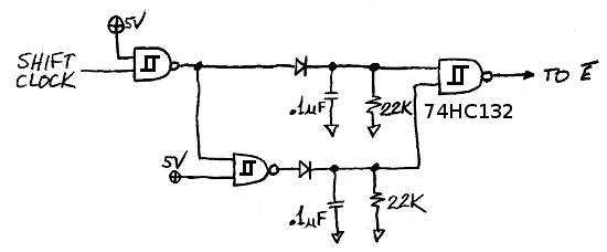

Garth wrote:You might want to implement some kind of hardware protection against overcurrent. What I'm thinking of is the possibility of a crash or other timing malfunction (especially before the debugging is finished) leaving a lot more current running through LEDs than they can safely take for more than a few ms. If the driver ICs have enable inputs, they could be driven together by a single circuit using an RC and a gate with a Schmitt trigger input so the enables will go false if clocking stops for more than a couple of ms for whatever reason.
Here's one idea of how to do it:
The two gates on the left are just used as inverters, but I drew them as NANDs so the whole thing could be done with a single IC, a 74HC132 quad 2-input Schmitt-trigger NAND gate. The time constant of the .1uF and 22K is 2.2ms, and depending on the actual thresholds of the final Schmitt NAND, it will take the input clock signal getting stuck in one state or the other for approximately that long to make the output go false. As long as the input toggles faster than that, the output stays true. The first input gate is just to keep the clock signal from being loaded down by a capacitor through a diode. Depending on your clock speed, you might want to modify the values. The time will be proportional to the capacitance times resistance. Actually, if you want to strobe the shift registers' output latches that often, the clocking will be nearly ten times as fast (or faster, depending on the length of the shift register chain), so you might want to make it a .01uF or even less instead of .1uF.

EDIT: ok.. I looked at the data sheet for the 74HC132 and everything has cleared up for me. I would connect the output form your diagram to the "OE" output enable pin on my 74HC595 shift register.. When this pin is kept Low the outputs are enabled on the shift register. Since your diagram keeps the output of the NAND chip high during shifting and low when taking too long I would have to invert this output to get it to work for me.
So if we are taking too long shifting through the rows the 74HC595 shift register outputs will be disabled, thus causing the darlington array driver it is activating to be disables as well protecting us from over current. Very cool!!!! I would have never known I could do this.Thank you Garth.
Just 1 question. In your diagram, the ends of the caps and resistors are going to ground or +5v(I'm guessing to ground) ? Also, That is 2 caps and 2 resistors in the diagram correct?
Edit 2: forgot one last thing. In your diagram.. are those capacitors polarized or non-polarized capacitors? Im assuming non-polarized from what it looks like.

waywardson07 wrote:EDIT: ok.. I looked at the data sheet for the 74HC132 and everything has cleared up for me. I would connect the output form your diagram to the "OE" output enable pin on my 74HC595 shift register.. When this pin is kept Low the outputs are enabled on the shift register. Since your diagram keeps the output of the NAND chip high during shifting and low when taking too long I would have to invert this output to get it to work for me.
No, it's NAND, not AND; so if both inputs are high, the output would be high except the little circle inverts the output so it's low when both intputs are high, meaning it will enable the drivers as long as the clock signal keeps going. So no, you don't need to re-invert the output.
Yes, two resistors, two capacitors, and two diodes. The diodes would preferably be Shottky ones for the lower forward voltage drop. Regular silicon ones will work, but they might require the resistors or capacitors to have a little higher value to give adequate delay to avoid unwanted shutdowns. You might want to experiment with the times anyway to make sure you're in the sweet spot, with enough time margin to make sure the drivers won't get shut down, but still short enough that there's no chance of damaging the LEDs from being on at high current too long if your program crashes during development.

waywardson07 wrote:Just 1 question. In your diagram, the ends of the caps and resistors are going to ground or +5v(I'm guessing to ground) ? Also, That is 2 caps and 2 resistors in the diagram correct?
The triangle pointing down is ground. The circle with the + in it goes to the 5V. Other than perhaps some tiny tantalum capacitors, I have not seen any polarized capacitors below 1uF. These are non-polarized. Monolithic ceramic would be my natural choice if thru-hole, or MLCCs if they're SMT. MLCCs' capacitance reduces quite a bit though when the voltage across them is more than about 20% of their WVDC, so make sure the WVDC is at least 25V, not 16. 50V would be good. If they were polarized though, the negative side would go to ground. Polarized are drawn with the negative plate curved, so you really don't even need the + and - markings in a diagram. If both plates are drawn straight, it's non-polarized. I should add: I would not use Z5U dielectric or anything with a 5 in it, as the temperature coefficient is really bad. You don't want the thing to quit working in really cold or hot weather. X7R will be fine.
