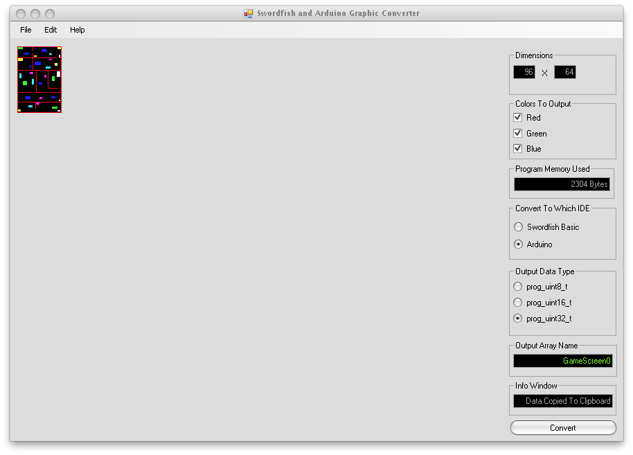

Hi everyone, I have been slowly working on my Graphic Conversion program for Arduino and Swordfish IDE's.
Basically it will allow you to open up a graphic (most probably one you have drawn yourself for a game you are making for a microcontroller) and you can then convert it into individual 1's and 0's organised into either bytes, words or longwords. It will output the data to either Swordfish Basic arrays or Arduino arrays.
It will be quite a handy project for those making their own games - right Joshua!
Hopefully it will be finished this weekend but here's a screenshot of the work in progress:

Well wait no more! Here's the initial release:
It's quite straight forward to use the only real requirement is that the width of your graphic is divisible by 8, 16 or 32 (because the output data will be in one of these formats). Just draw your image up in Paint.
You can then select which colors you want to actually get spit out in the output (for example, for your RED / GREEN matrix game Joshua, you would only need the red and green data) As you select these it will update the program memory required for the graphic.
Select what programming language you are using (it will update the output data types to suit) and then select which output data type you want (lots of 8bits, 16bits or 32bits)
Type in the name that you want your array to be (for example if you have a picture of a room in a game you are making, you might call it Room1)
Then click convert (and wait a few seconds - or longer depending on how big the image is and the speed of your computer) A message box will appear telling you that the data has been copied to the clipboard. All you need to do is paste it into swordfish or arduino.

This is a nice program. It may also be useful if you could choose whether the data outputs a color as a 1 or a 0. (example: red black red is either 101 or 010.)
I found a few few problems/bugs though:
I put red and green in a picture and the program switched the data (red is green, green is red.)
I tried putting yellow into a picture and it did not do red or green.
I put orange in the picture and only updated MyDataGreen (so probably red.)
The data set the program outputted:
const prog_uint8_t MyDataRed[8]PROGMEM={0b11111001, 0b11111101, 0b11111101, 0b11111101, 0b11111101, 0b11111001, 0b11110000, 0b11111110};
const prog_uint8_t MyDataGreen[8]PROGMEM={0b11000110, 0b10111010, 0b10111010, 0b11111010, 0b11111010, 0b11110110, 0b11101111, 0b10000001};
Bugs or no bugs, this is still an awesome program! It'll make map making a whole lot easier for my game!.

Re: Arduino and Swordfish Basic Graphic Converter
No Worries, I should be able to add that tonight.This is a nice program. It may also be useful if you could choose whether the data outputs a color as a 1 or a 0. (example: red black red is either 101 or 010.)
I haven't been able to replicate this fault - red comes up as red and green as greenI put red and green in a picture and the program switched the data (red is green, green is red.)
Same as above, there must not have been enough red in the colorI put orange in the picture and only updated MyDataGreen (so probably red.)
Thanks for the feedback, I'll make these changes and then see how it works for you. Once you think it's all good - I'll release it out on the arduino forums etc...Bugs or no bugs, this is still an awesome program! It'll make map making a whole lot easier for my game!.
My bad, I forgot to put black in the areas that were white, so I thought 1 was off (which is why I wanted an ability to change that) which made me think that red and green were switched...
Anyway, it works fine now that I realize what it does, and yellow IS both red and green.
Thanks Brad!
(Sorry for my misconception.)
Thanks Brad!

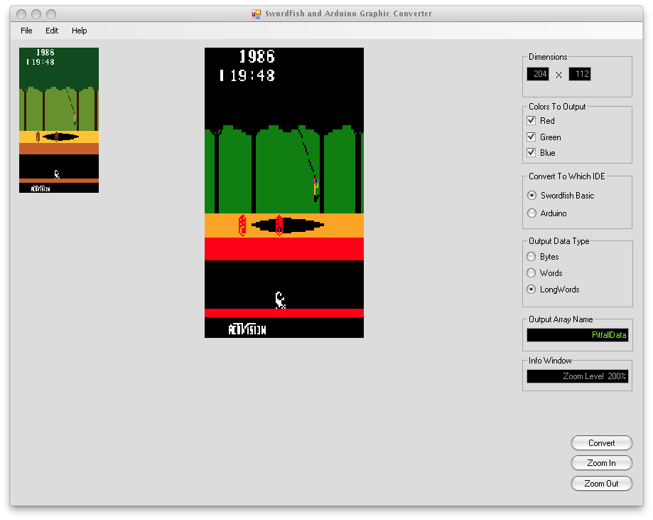

Well I added more features anyway!
Now there is a color adjustment (which basically just changes how bright the colors need to be to be included in the conversion. You will need to click convert each time you adjust the color setting.
I have also added an invert data option so now you will get logic 0's to turn the LED's on (great for common anode matrix devices)
I have also brought back the output image preview - so you can see what the image will look like on a matrix display - great for when you are trying to get the color adjustment just right!
Not a new feature but you can click and drag the original image and place it where ever you like - perhaps next to the converted image to see the difference...
Here's some examples of different color settings with a sonic the hedgehog image: (notice the higher the number, the harder it is for a color to get counted in the conversion so the darker the output looks. And here's the download:
