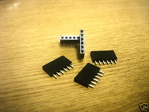

The other way would be to use pin headers like these, they make the use of add on boards/daughter boards like AVR and the Amicus18 boards, they use boards that interlink on each other with pin headers. I still think that using some of these pin headers anyway would be good for pluging your LCD into the board etc :)
