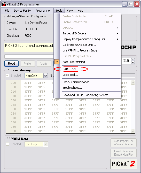

Have you guys ever used the pickit 2 UART feature?
MAN IT IS HANDY!
I have been using it to help me understand exactly what is going on with my project in order to get it to work as I had planned.

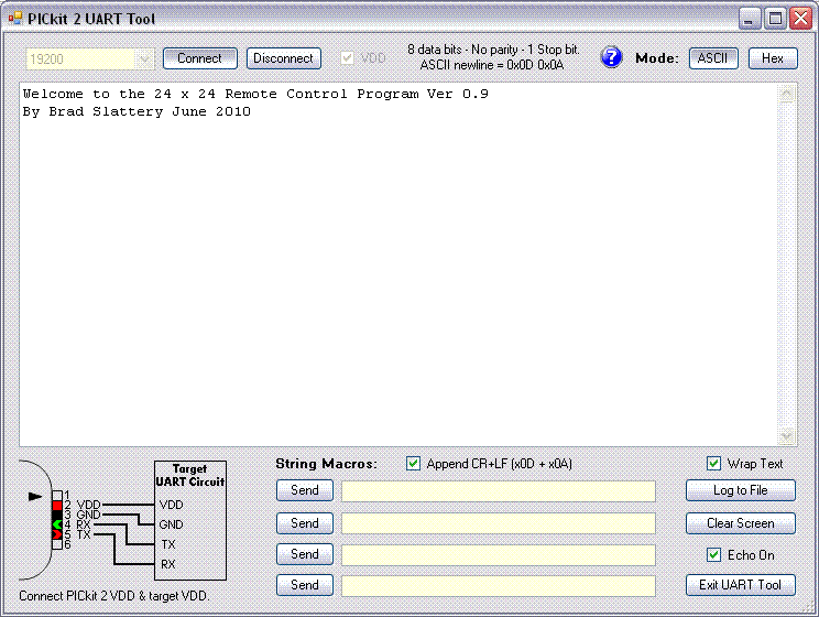

The code has been a little tricky, but the UART tool helps me along the way.
How? you may ask...
Simple, everytime I send out a command to the display, I also send the same info through the UART which will display on my laptop screen exactly what info is being transferred.
Here is a little example:
you can also use it to send data from your computer to the pic to give commands or something like that.
Very handy indeed!
