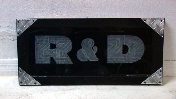

Sorry for skipping out on the conversation guys but I got really busy at work and haven't had the opportunity to chat much on the forum.
I also started a project that was supposed to take only a few hours over the weekend but somehow ended up taking up the majority of the weekend and I still didn't finish. :x
I was hoping to show you the finished product but it will have to wait. For now here is a sneak peek...

Post by brad » Thu Jul 28, 2011 9:10 pm
What is that crazy thing? a doomsday device? A flux capacitor?

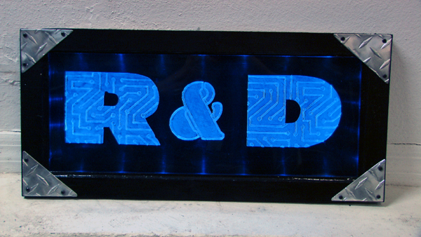

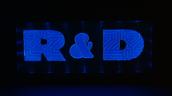

Post by sdudley » Fri Jul 29, 2011 12:49 pm
No silly, it's an edge-lit acrylic sign I am going to hang above the entrance to my lab at work! :D
Finished...
PS> Forgive me for hijacking the thread... now back to the programming topic! :mrgreen:

Post by brad » Fri Jul 29, 2011 9:08 pm
You are the thread hijacker!
By the way, nice sign!
