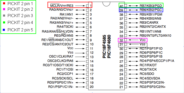

i am having some trouble finding out which pins to connect the pickit2 programmer. anyone that got a drawing whit this on..
Re: Pic18F4680
Post by brad » Thu Apr 07, 2011 5:08 pm
No problem. Here's the connections:
