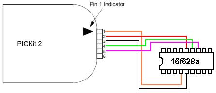

The pickit2 will always connect to each pic microcontroller in the same way, like this:
You need to do this because each LED segment has a different forward voltage drop. When you say that you tru and mix with red, but only the red comes on makes me think that you don't have your resistors like the picture above. Red normally has quite a low forward voltage drop compared to green and blue, so if you try and turn on red and something else - you are actually just connecting two LED's together in parallel. The red will turn on, but since the green or blue is in parallel with the red, there is not enough voltage to turn on the green or blue. Having resistors like that shown above gets rid of this problem.
- pickit2_connections.jpg (11.36 KiB) Viewed 36287 times
