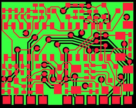

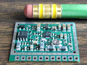

    Today our company does mostly SMT though, and the only parts that are thru-hole are the connectors which have to handle a lot of force. Here are two of my recent postage-stamp-sized analog designs. The second one has 66 components. The smallest parts are 0402 size. I am not allowed to go below that, for example to 0201, 01005, etc.:

In the pictures near the top, you'll see an inductor at 22° in the top-right; but I had to make it as a separate component rather than rotate the one I had made earlier. It's very quick and easy to make PCB components in this CAD, except that if it's for SMT, I can't rotate the rectangular pads at arbitrary angles. It doesn't matter for thru-hole parts where a round pad at any angle is the same thing.
