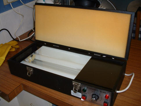

Another way is the UV light and photoresist board way, which can be found here:
http://www.technologystudent.com/pcb/PCB3A.htm
UV light boxes are quite expensive at around £100.
uv light.jpg (25.56 KiB) Viewed 28899 times

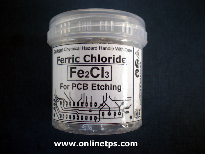

Your will also need Etching chemicals - where the excess copper is removed to leave the individual tracks or traces.

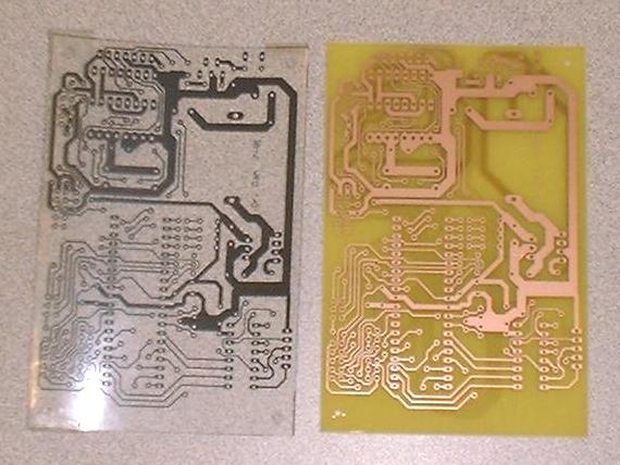

So you could end up making boards like this? Single or double sided:

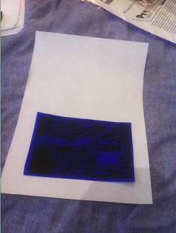

Heres a tip for using Press N Peel to make PCBs:
To make the PnP sheet/sheets last as long as possible, print on a piece of plain paper, then cut out a piece of PnP to the right size and tape it onto the printout, dull side up, using scotch (clear) tape, or something close enough?.
Then print out your (pcb) design again by reloading your paper into the printer (obviously noting which direction/side your printer prints onto!) and then this time the pattern is printed onto the piece of PnP.
Setting your laser printer to its darkest setting will get more toner on there, which can help if you have adhesion problems, but in general with PnP I find it's not all that necessary.
I think its important to trim the edges of the PnP quite close to the edges of the pattern - during ironing, the free edges of the pattern will tend to warp and can cause adhesion problems with traces near the edge.
pnp on paper.jpg (10.3 KiB) Viewed 28875 times

For etching found 1 part Muratic acid to 2 parts Hydrogen Peroxide works very well and much cheaper than that icky brown stuff. With the Muratic acid/Hyd Peroxide mix you can see your progress.

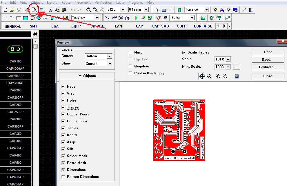

Now to figure out how to print only the bottom or top traces without the parts outline.
Re: Making your own PCB - Printed Circuit Boards
Post by bitfogav » Tue Feb 22, 2011 7:07 am
I always use the Preview symbol which opens up the preview window of your PCB, in here you can un-select the objects that you dont want to be visible, and then print out what you want :)
